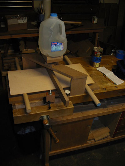

I have pretty much the same set up you just decriped for testing tops. I'll try to get a picture of it and post it tonight. It's not perfect and perhaps we can redisn it somewhat. But it does work pretty well as it provides repeatable results.

PostPosted: Tue Jul 26, 2005 4:31 pm
Posts: 2996
John,
heres a couple of pictures of my test set up. The wooden dowels that the top rest on are a bad idea as dowels aren't straight. PVC or steel pipe/tube would be much better. Also more thought needs to be given to the mounting of the dial indicator. I just clamp it to my bench, which works ok, but I'm sure you could come up with a better way.
The first pic shows the whole set up in use. There are 2 sets of grooves that the dowels can set in allowing me to rotate the top and test it in each direction.

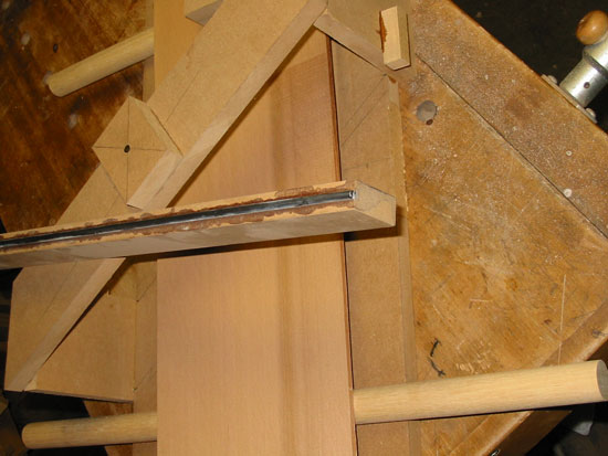

The second is a picture showing the bottom of the beam that the load is applied with. It has a 1/4 steel rod that contacts the top, which spans the whole width/length.
anyway,food for thought, maybe a good jumping off point, maybe not.

Jim
Great pictures. Thanks.
   From the bottom picture it looks like the block of wood with the X on it is a pedistal that must have a rod that goes down and transmits the weight of the water to the bar below. Very clever. That keeps the weight centered over the bar and balanced at the same time.   If a gallon of water weighs about 3.8 kilos, or a little over 8 pounds (if my morning math brain is working) that seems to be a lot of weight. How much deflection are you getting with that amount of weight? Are you testing a joined top or just a half of a top?
     Is the dial micrometer in the center of the plate or near one edge?
Thanks for the pic
PostPosted: Wed Jul 27, 2005 5:47 am
Posts: 2996
John,
The block of wood with the X on it is the weight platform.
I test the unjoined halves. I sand them just enough to clean them up and get them an even thickness.
A gallon of water + the platform + the beam and all the weight is approximately 10.3 lbs. This is much more than I thought I would originally need. The example I just looked up in my records shows a top that was .158 thick had a deflection of .109.
interestingly enough the deflection is in a very similar range when testing each direction, this is due to the differences in modulus and span lengths for each axis. Just worked out that way, nothing I actually planed for!
The dial indicator sits directly under the 1/4" rod at the end of the plate.
As a side note one thing that I've found and not surprisingly is that the denser spruce is almost always the stiffer wood. There are exceptions however. You can also easily hear the difference in the wood for the least stiff to the stiffest, assuming they are all the same dimensions. Jim_W38560.6522337963
